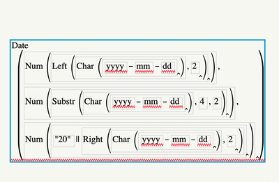

Marc3
Level II
Re: change date format
Screen Shot 2019-09-24 at 8.58.54 PM.pngScreen Shot 2019-09-24 at 8.59.58 PM.png
Highlighted
txnelson
Your reponses and question appear to me that you are not understanding how JMP handles date values.  JMP handles dates and times, using a numeric value which is equal to the number of seconds since Midnight, January 1st, 1904.  The way that JMP converts this into one of the displays of 09Feb2015, or 02/09/2015, etc. is to set a JMP format on the column that has the numeric values.
Therefore, if you have a character column, called "Date", with the values like "25.04.15", and you want to convert that into a JMP Date value, you can create a new column and if you apply the following formula,
Date DMY(
			Num( Left( Char( :Date ), 2 ) ),
			Num( Substr( Char( :Date ), 4, 2 ) ),
			Num( "20" || Right( Char( :Date ), 2 ) )
it will take the character value of "25.04.15" and convert it into 3512764800.  This is the number of seconds from Midnight January 1st, 1904 until Midnight, April, 25th, 2015.  Now what is missing, is that you don't want the data displayed in the number of seconds.  What you want, is for the value to be displayed in the data table, and on your reports in 2015-04-25.  To do this, you just set the format for the column to "yyyy-mm-dd".  The advantage of storing dates in this numeric form is that one can then order the data by date, and can do addition and subtraction on the values, or even calculate the mean date etc.
