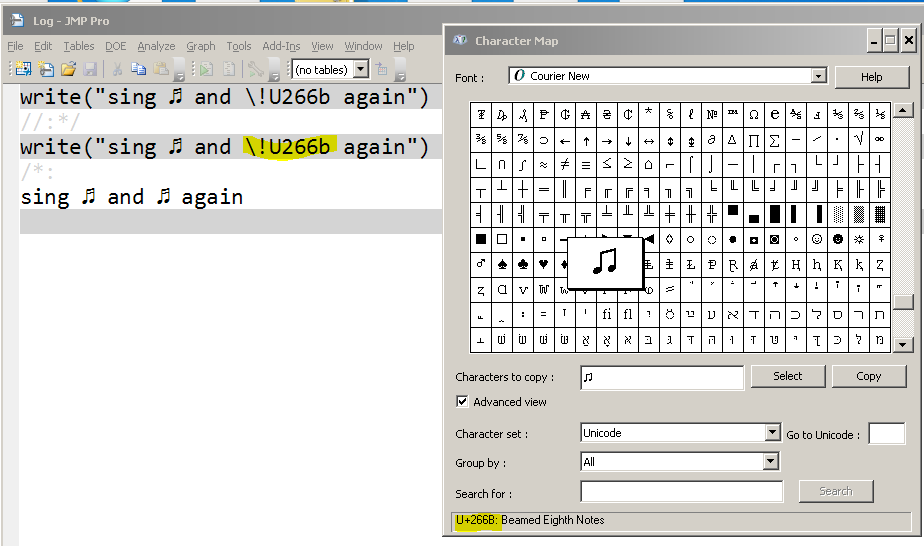

There are a number of web sites that make it fairly easy to get the Unicode hex data; I've used Windows Character Map here:
Unicode escapeUnicode escape
(edit) If you open the file again, I'd suggest trying windows 1252 as a starting point. I think Load Text File has options for specifying the character set without using the preferences.
Set it back to Best Guess when doneSet it back to Best Guess when done
