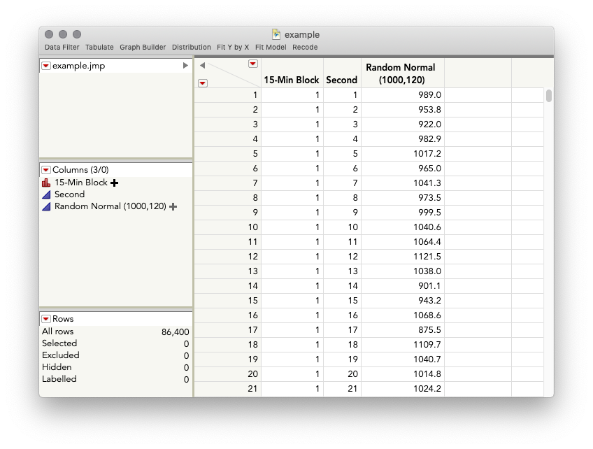

The distributional shape of the population doesn't matter. Variances work this way regardless of the underlying form. We don't have to trust the math, either. Let's do this up in JMP and see what happens. Here's a table of 86,400 observations, your 1sec resolution table:table original.pngtable original.png

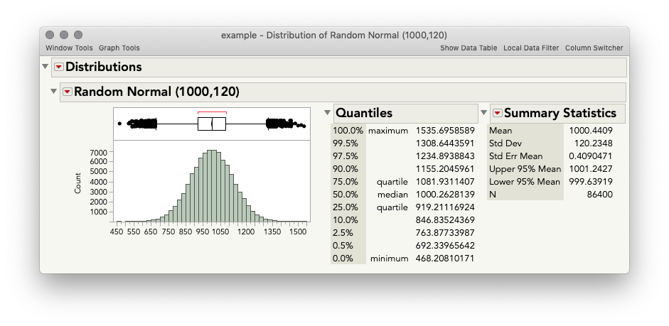

This is the distribution of the original variable, made with a Random Normal() function: Mean of 1000, Standard deviation of 120 (well about, this is a random function, so it's close). dist1.pngdist1.png

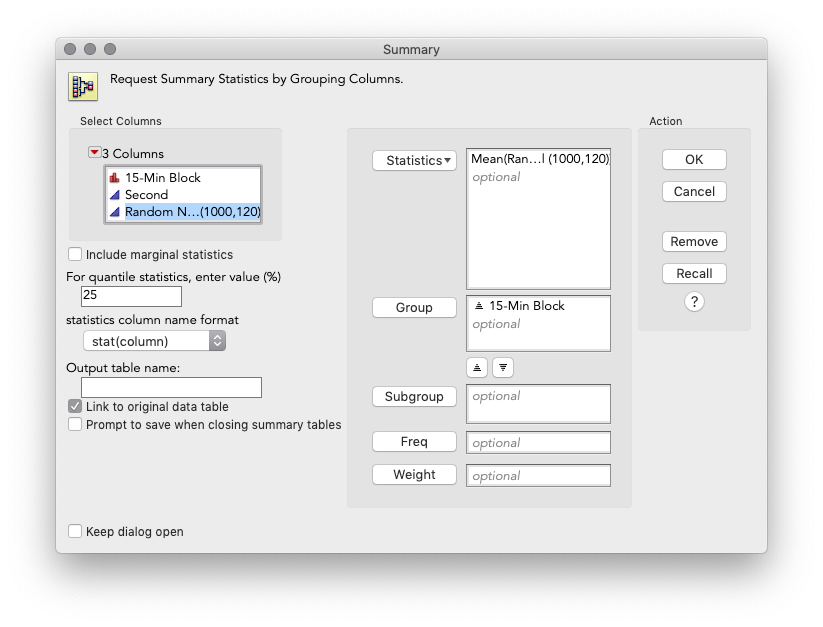

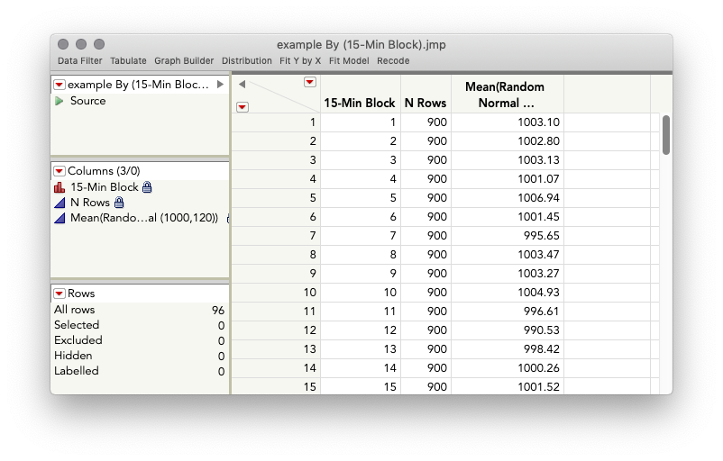

Let's summarize by 15-min block using Tables > Summary:summary.pngsummary.png
This gives the summarized table below, with the mean for each block.summary.pngsummary.png

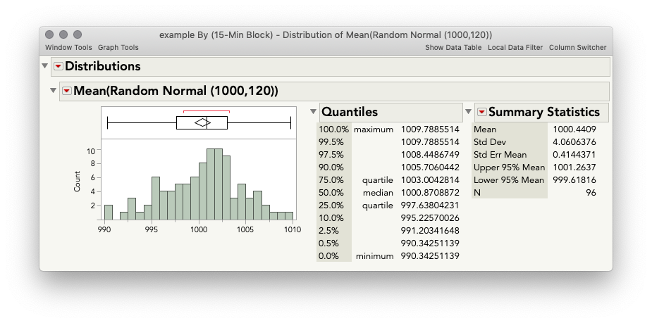

Let's take a look at the distribution of the means (which is essentially what your final table is):distmean.pngdistmean.png
And there we go, the standard deviation of the sampling distribution of the mean (which is what we've built) is 4 -- sigma / sqroot(n) just as theory tells us.
One caveat... this empirical sampling distribution is just 96 observations of the theoretically infinite sampling distribution, so every time you repeat this experiment you will get a slightly different estimate. If we were to build the original table to have millions and millions of 15-minute blocks and then sample thousands and thousands of means of those 15-minute blocks, we'd be pretty dead on. We could show this empirically, but we know it theoretically. And, the point really is that our best, unbiased estimate of the population sigma when we have the standard error (the standard deviation of the means), is to take that standard error and multiply it by sqroot(n).
So, TLDR: take the standard deviation you have of the means, and multiple by sqroot (900).

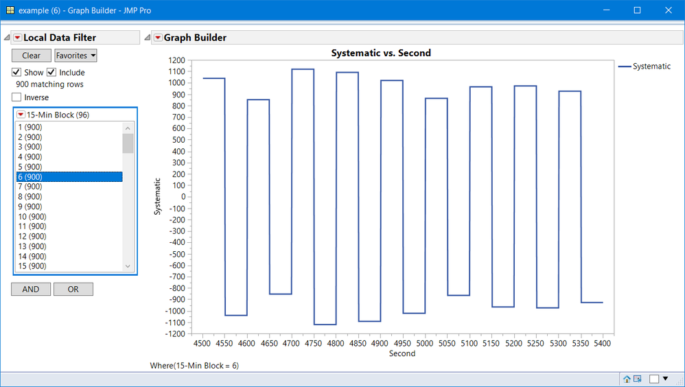

@jules 's response is a perfect answer if the underlying data is random with no strong systematic effects. The counter example below is extreme, but demonstrates how a systematic effect can result in a very stable mean, and hence, the std dev of the mean is an underestimate of the std error.
Using Julian's table, create a column called Systematic with the formula:
If(
	Row() == 1, Random Integer( 850, 1150 ),
	Modulo( Row(), 100 ) == 1, Random Integer( 850, 1150 ),
	Modulo( Row(), 100 ) == 51, Lag( :Systematic, 1 ) * -1,
Below is a screen shot of of the individual one second data for a selected 15-Min Block
You can see there is variation in the raw data. However, the summarized 15-Min Block data, all the means are zero, because this example is purposely set up to be an extreme case. Even if the systematic effects were not this extreme, a strong systematic pattern can make the mean artificially stable.
This counter example is not meant to undermine @jules 's solution, but meant to be a caution. If at all possible you should try to find a method to get to a couple random intervals of the raw data, to rule out strong systematic, cyclic events.

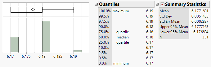

Thanks so much for the detailed explanation.  However, there is something going on with my data such that this is giving me results that don't quite make sense.
I have a data set from >80 hours, not just 24 hours.  So, > 300 samples.  The StdDev of the 15mAvg values is 0.00513.  With 900 1-second data ponts per 15-minute period, that would imply a population StdDev of 0.1538 (= 0.00513 * 30).  However the total range of my data over the 80+ hours is only 0.05 Max(15mMax) - Min(15mMin).  I would have expected the range to be several SD's not a fraction of an SD.
I wonder if I'm running into a "quantization problem.  The resolution of my samples is 0.01, which is 2x the SD that I measuring on the sample averages.
I don't know if that's somehow skewing the results.
I actually have > 200 of these data sets, for different "channels", and typically the Range is 3x to 5x the StdDev of the sample means.

"The StdDev of the 15mAvg values is 0.00513... that would imply a population StdDev of 0.1538 (= 0.00513 * 30).  However the total range of my data over the 80+ hours is only 0.05 Max(15mMax) - Min(15mMin).  I would have expected the range to be several SD's not a fraction of an SD."
I can see how that might seem strange, but what you have is the range of the means of samples of size 900, not the range of the original data. if you look in my example before, the range of my means of size 900 was around 20. The range of the original data was over 1000. By collecting observations together and calculating a mean, the resulting numbers, each of them a mean of 900 observations, tend to be close to one another than the original data points are close to one another (and that's why we can state that the standard deviation of sample means will be smaller than the standard deviation of the original data by a factor of sqroot(n)). So, back to your case, the range of your means is 0.05, which given samples of 900 we know is substantially smaller than the range of the original data. Thus, it shouldn't be surprising that the standard deviation we estimate for the original generating data is larger.
"I wonder if I'm running into a "quantization problem.  The resolution of my samples is 0.01, which is 2x the SD that I measuring on the sample averages"
Given what we know from the sample means here, we should expect that the range of the data in the original 1sec samples is larger, so hopefully, you're not in a situation where your measurement device isn't capable of accurately measuring the phenomenon of interest.  I can't really speak to that, though.

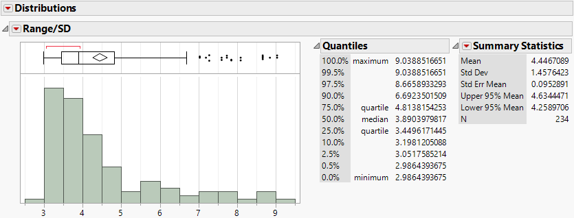

"I don't know if that's somehow skewing the results.  I actually have > 200 of these data sets, for different "channels", and typically the Range is 3x to 5x the StdDev of the sample means."
I agree that we should expect that the range of the sample means is larger than the standard deviation of the sample means. But, that's even true in the first plot you showed, Range = 0.05, and StDev = 0.0051. However, with samples as large as 900, we shouldn't expect that the range of the sample means is larger than the standard deviation of the original variable from which the samples are drawn.
