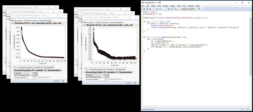

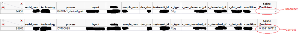

Hello.  I have created an array of strings, containing the various values found in one of my columns. I would like to generate a spline for every value that is in my array of strings, and save all predicted points to a new column.  I am able to iterate over Bivariate(), changing a where-clause with each iteration to a new value in my array of strings, however, only the last predicted points are saved to a new column.  How do I get all predicted points to be saved into a new column?  Thanks.
Proc = "new";
processArray = {};
DataCV=open("C:\Desktop\JMP\sample_data.csv");
for (l = 1, l < 32521, l++,		// Generate array of strings
	if (proc == (Row()=l; :process),
		print("same process"),
		Insert Into(processArray, (Row()=l; :process)); proc = (Row()=l; :process); Show(proc)
for (n = 1, n <= length(processArray), n++,	// Generate and save multiple predicteds
	biv = Bivariate(
		Y( :c_mm_deembed_pf ),
		X( :v_dut_volt ),
		Where( :c_type == "Cdg" & :process == processArray[n] ),// :process == processArray[n] appears to be working, as 6 splines are generated
		Fit Spline( 0.1, standardized, {save predicteds})	// {save predicteds} is not saving all 6 splines, only last spline

And, I just thought again about the Predicted formula for the Predicted column, and realized that the process you are using is going to write on top of each other as they are processed.  I suggest that you rename the Prediced column after each execution of bivariate, forcing each iteration to end up creating a new column.
Jim
