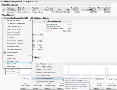

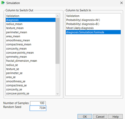

Saving a simulation formula can help you assess the coefficients distributions of your model, by switching in the diagnosis response with the diagnosis simulation formula : Simulate
The simulation formula is just a condensed version of the prediction formulas you can save from the model fit report: instead of having one probability column for each class and a final classification column, you only save one column with probabilities calculation and classification inside the same formula.
If you're more interested in the robustness of your model regarding variations in your inputs, then using the Simulator from Prediction Profiler with variations in the inputs (and possibly adding noise in the output) and run a Simulation Experiment may help you. You can then generate variations in your inputs, and possibly shift the distributions of your features to see how it affects your model, as well as increasing noise to see how robust your prediction model might be.

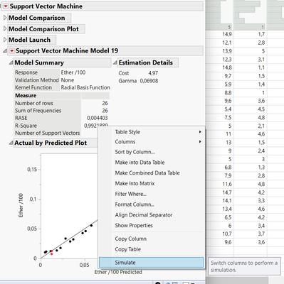

I guess I'm going to learn some new JMP features.  Please tell me where you got the Simulation window with the Columns to switch out that you are showing.  I can't find it anywhere.  I do see where to run simulation experiments, but I can't find anywhere that prompts saving a simulation formula.  Thanks.

The simulation feature can be accessed by right-clicking on any panel/report of model platform : Launch the Simulate Feature
Here as an example on model summary of SVM :
Then you'll be prompted to choose the columns to switch in and switch out. In the context of Simulate, you could use it on the parameters estimates of a linear regression model, switching out the response with the simulated response to assess the parameters estimates distribution, or on the model summary to assess the consistency of the model's performances : The Simulate Window
Concerning the simulation formula, it can be found and saved as one of the options under "Save Columns" in the Generalized Regression platform :
I use this "Simulate" option to assess robustness of Machine Learning models using a Validation column formula. Using this column as a validation in the model dialog window, I can then simulate and switch in and out these column values, to represent slightly different training/validation/test sets with the same stratification or grouping method. It can help assess robustness of the algorithm (like cross-validation would also enable : https://community.jmp.com/t5/Discussions/How-can-I-automate-and-summarize-many-repeat-validations-in...), and possibly test the performances improvement (if any) of the model by fine-tuning the hyperparameters (https://community.jmp.com/t5/Discussions/Boosted-Tree-Tuning-TABLE-DESIGN/m-p/609591/highlight/true#...).
