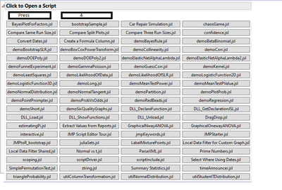

@jthi and @txnelson If I could pick your brains one more time on this:
If I wanted to add in a number edit box that had the value for the Line up box and then a button box to press that would apply the value in the number edit box to change the orientation of the script buttons in the window how would that look?
So something like this
jthi
Re: Dynamic list of buttons linked to scripts in a folder
This might give an idea how you can do it
Names Default To Here(1);
init_cols = 4;
dir = "$SAMPLE_SCRIPTS/";
dir = Convert File Path(dir, windows);
files = Files In Directory(dir);
jslfiles = Filter Each({filename}, files, Word(-1, filename, ".") == "jsl");
// Not sure how you would like to determine column count, but with Lineup box it is fairly easy
lub = Lineup Box(N Col(init_cols));
For Each({filename}, jslfiles,
	Eval(EvalExpr(
		lub << Append(Button Box(filename,
			nw = New Window(Expr(filename),
				Script Box(Load Text File(Expr(dir || filename)), "JSL", 600, 600)
nw = New Window("Scripts in " || dir,
	Outline Box("Click to Open a Script",
		V List Box(
			Lineup Box(N Col(2),
				Button Box("Press to update Col count", << Set Function(function({this},
					lub << N Col((this << sib) << get)
				Number Edit Box(init_cols)
			lub
Number Edit Box can also trigger on commit (<< Set Function()) / change (<< Set Number Changed()) so you don't necessarily need a button
-Jarmo
