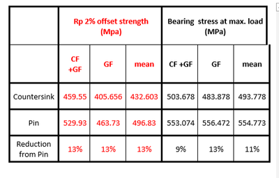

Hi, it my first day on JMP, so basicly it is very simple question...
I would like to add a formula row to the tabel.
how can I do that?

so what the best way to build a table like this (built with excel...) ?
the columns mean is the results  ( of RP2% and Bearing) without separeted to the Variant (GF \ CF+GF)
attached the data file

Orienting the table differently would make it easier to calculate your percent difference in the manner outlined by txnelson.
Using the data you provided, orient the table this way:
Now right-click and make into data table. Add a column for the formula that you have outlined (pin-countersink)/pin.
I'm sure there are other solutions, but this one does work.
Dan Obermiller
