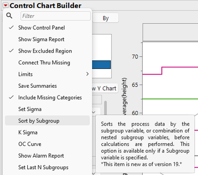

jthi
Re: Xbar Control Charts require Table to be Sorted by Subgroup?
Which JMP version are you using? In JMP19

jthi
