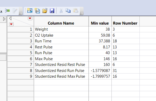

After this step, the user gets a JMP table like the one below as an output with options whether to remove the value extracted by the script or not:
The user either removes the value from the main table or decides to keep it.

dt1 = new table( "Data",
	New Column( "Column Name", character, nominal, values(Names)),
	New column( "Min value", numeric, nominal, values( MinVals)),
	New Column( "Row Number", expression, nominal, values( MinValList ));

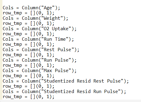

I get this output for row_tmp

I probably should have included a "[1]" on the end of that definition for row_temp. Sorry, I'm shooting from the hip a bit here without actually running this through JMP with an example data table.  Make sure to wrap the whole thing in parentheses before adding the [1].
(row_tmp <span class="token operator">=</span> dt1 <span class="token operator"><</span><span class="token operator"><</span><span class="token messages"> Get Rows Where</span><span class="token punctuation">(</span><span class="token punctuation">:</span>Column Name <span class="token operator">==</span> Cols<span class="token punctuation">))[1]</span><span class="token punctuation">;</span>
 You probably are also comparing to a name object rather than a string.  To get the column name as a string, try this:
Cols = Column(dt, 1) << Get Name;
I think with both of those changes, it should work.

@cwillden I'm sorry, it still doesn't work for me. I just want to check if Min Values are still present in the columns of Linnerud table. But I am unable to make that script to work.
