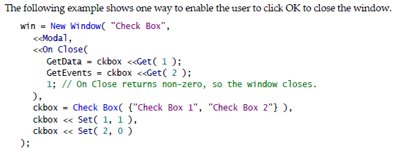

Re: How to Set a Check Box to default on?
There is already a solution in the scripting guide, by the way:
Hegedus
Level IV
I am using JMP 12 and I did a search of the scripting guide and your example was not found. Perhaps it only exists in the latter versions.
