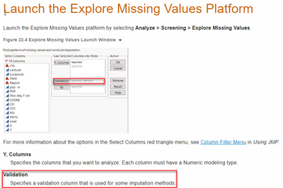

I have discovered that JMP can consider the name of the imputation variable as such. On the webpage https://www.jmp.com/support/help/en/17.2/?os=win&source=application#page/jmp/launch-the-explore-miss... for handling multiple imputation data, there is a validation window which accepts the SPSS variable 'imputation_' as a valid input and produces a missing data report.
Could this validation window for the imputation_ variable please be added to other types of analyses, for instance, the multivariate analyses types such as MANOVA with repeated measures? I work at an institute that has mainly longitudinal data so there is always attrition that needs to be compensated with multiple imputations. Thus, it would be just great if JMP could solve this problem that otherwise only R appears to be able to muster.
