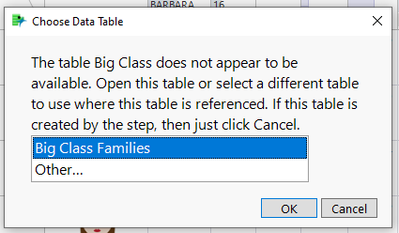

A kind of workaround:
close the original table. Then workflow Builder cannot find it and will ask which table to use:
The advantage - and disadvantage:
When you save the Workflow now, Jmp will save this replacement info - and next time it will search for the new name and not for the old name anymore.

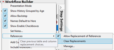

The replacement rules can be activated, checked and reset via the red triangle:
maybe: use a very strange table name when recording the workflow ... then rely on the replacement function
- and reset the replacement rule before you save the workflow [such that Jmp will search again for the table with the strange name].

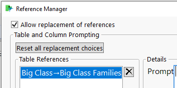

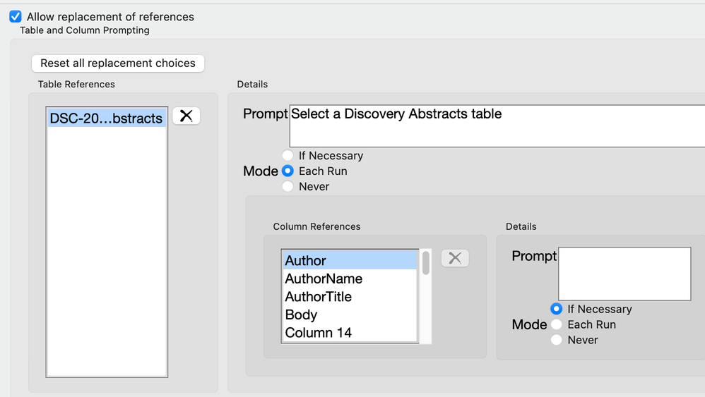

Hi. I would suggest using the Workflow Builder option, References > Manage... This will allow you to specify when to prompt for data table or column references.

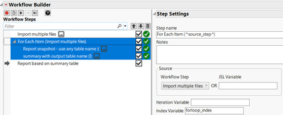

With Jmp18, there is a new approach which doesn't require any scripting *)
https://community.jmp.com/t5/Benelux-JMP-Users-Group/Workflow-Builder-or-the-quot-baby-steps-quot-in...
1) use a workflow step #1 to open/create new table(s):
Subset by, open(), Multi File Import ...
2) Select step #1 as "Source" for a FOR EACH loop
3) and add as many workflow steps as you want to the For Each branch:
independent of the Data Table name in the individual steps, for all steps in the For Each loop, Jmp will use the the tables which were opened in step #1 :)
*) at the moment, the approach doesn't works for ".jmp" files.
