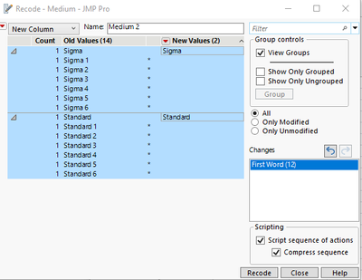

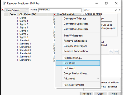

JMP can also create the Word column shown by @Georg interactively (might need some additional handling for non-matches).
Right click on column header and create new formula column:
or use recode:
-Jarmo
