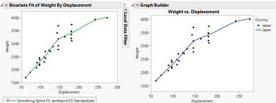

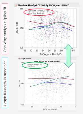

As below smooth fitting results(same datasets) in JMP when using the One Way Analysis (Fit Y by X) platform vs. Graph Builder, by setting the same lambda=100, the smoothness of the curve is totally different. (Fits are the same even if the lambda values differ by approximately 20x)
The graph builder uses standardized X variables. To get the same line in Bivariate, choose 'Other...' under the Red Triangle > Flexible > Fit Spline, use a lamda of 0.05 (default in graph builder) and check 'Standardize X'.
Standardized X means that you normalize your X distribution:
x = [[[ ARRAY OF X VALUES ]]]
x = (x - Mean( x )) / Std Dev( x );
After this, you'll create your cubic smoothing spline polynomials, then when creating your splines (which will be placed into this new scaled-x space), you simply unscale your spline's x-values.
I have a bit more data that I used and I get a very different spline fit using the graph builder and bivariate spline fit. The graphs have the same scales, and there seems to be a horizontal shift in the splines.
The graph builder is on top while the bottom is from the bivariate fit.
