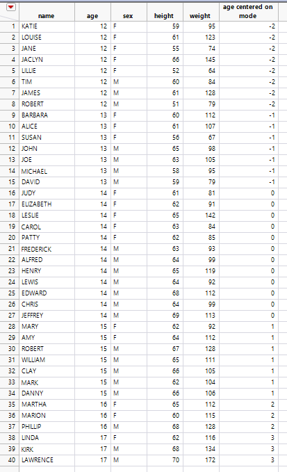

There is also a mode function that finds the most common value in a matrix; you can turn it into a column function like this:
dt = Open( "$sample_data\big class.jmp" );
dt << New Column( "age centered on mode",
    formula( :age - As Constant( Mode( dt:age << getvalues ) ) )
The <<getValues message returns a matrix of values from the age column. The AsConstant function calculate the mode once, and treats that value as a constant for the rest of the column (speeds it up, not strictly necessary).
Column using ModeColumn using Mode
You can change mode to mean and see a different set of numbers.
Craige

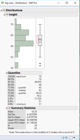

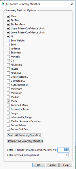

1.  If you go to
     Help==>Statistics Index
and scrolled down to "Mean" you would see where it is surfaced in JMP
2. It is available under the red triangle options in the Distribution Platform
     Display Options==>Customize Summary Statistics
Jim
Craige
