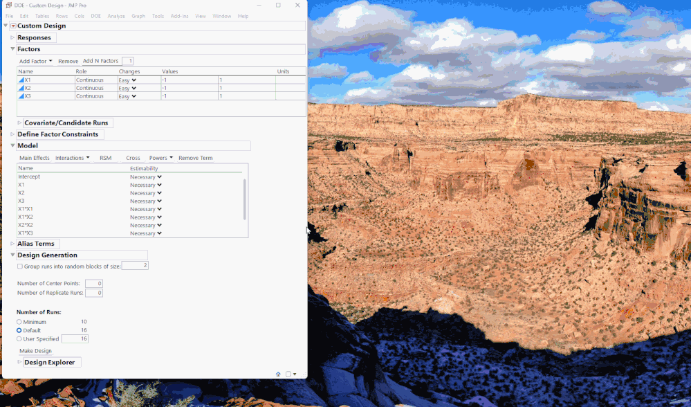

Assuming you're using the Custom Designer, the default behavior is to create a design that focuses on a small number of runs, rather than maximizing power. You can use the Design Explorer (GIF below) to explore what adding more runs does to power.
