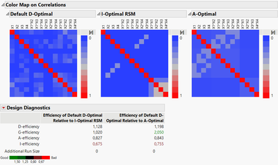

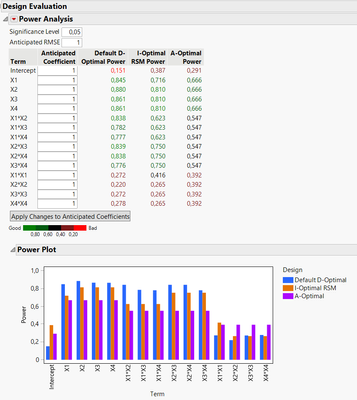

Here is a visual comparison of 3 DoEs with 20 runs for 4 factors, with a default D-Optimal design, a RSM I-Optimal design and a A-Optimal design, with weights 2 for quadratic effects and 1 for the others. You can see how both of these options improve power for quadratic effects, but at the expense of something else (power for main effects and/or interaction effects):
The prediction variance profile over the experimental space is also different between the three designs, with the default D-Optimal design having a slightly larger but constant prediction variance over the experimental space, and the two other options having a lower prediction variance over most of the experimental space, but higher prediction variance at the extremes of the experimental space:
The correlation maps also show interesting differences between the three designs (no correlations/aliases between quadratic effects and other effects for the A-Optimal design):
