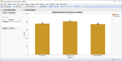

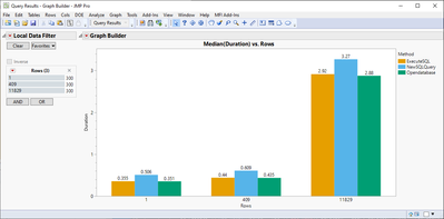

Re: Which way to go query database?
I have done some testing with New SQL Query and I feel like it does have some nice features which are implemented in such a way that I wouldn't really use them, such as functions used with OnRunComplete/OnRunCanceled/OnError must be in global namespace. Maybe I could write some very general functions which could be used with these but still... it is global namespace.
It also seems to be slower than Open Database or Execute SQL (especially before the query starts) which could be an issue if you were to run multiple small queries. Maybe I would have to modify my dns string somehow when using New SQL Query (outside adding ODBC:)?
Most likely I will stick to "older" methods of querying unless I need to be able to run my queries in the background.
-Jarmo
