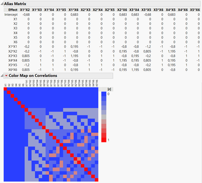

Hi Victor, is it right to state that a Definitive Screening design is a special case of an Optimal DOE where two basic conditions need to be fulfilled: (1) all main effects are orthogonal and not confounded and not confouded with other model effects (pure) and (2) no aliasing between quadratic and interaction effects. Correct?
Victor_G
Re: Space filling versus optimal DOE
Hi @frankderuyck,
Definitive Screening Design is a "textbook"  (classical) design, used for a screening case with high number of factors involved and the possibility to test interaction and quadratic effects, following the basic principles of DoE : effect sparsity, effect hierarchy and effect heredity. I wouldn't categorize this design as an "optimal" design, as the structure is "fixed" (and so are the terms screened by this design).
Concerning your conditions,
  1. Main effects are completely orthogonal to each other, to 2-factors interactions and to quadratic effects.
  2. No, there are aliases between quadratic and interaction effects :
Here is an extract from the presentation of Tom Donelly about the desirable properties of DSDs I attached earlier :
I hope this answer will help you.
You can also search for presentations about DSD from Bradley Jones in the JMP Community, he clearly demonstrates when/where to use DSDs, and the conditions to fulfill (only continuous and few 2-levels categorical factors, high number of factors, no constraint in the experimental space, easy to change factors, ...).
