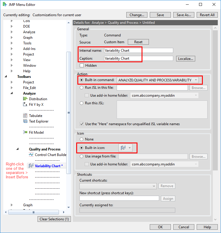

Re: Where did the variability chart toolbar item go and how to get it back please?
Here is an image of the JMP Menu Editor where I added a button for calling the Variability Chart platform.  Instructions for adding a toolbar button can be found in the Personalize Toolbars and Menus on Windows section of Using JMP (Help > Books > Using JMP).
Hope that helps!
Wendy

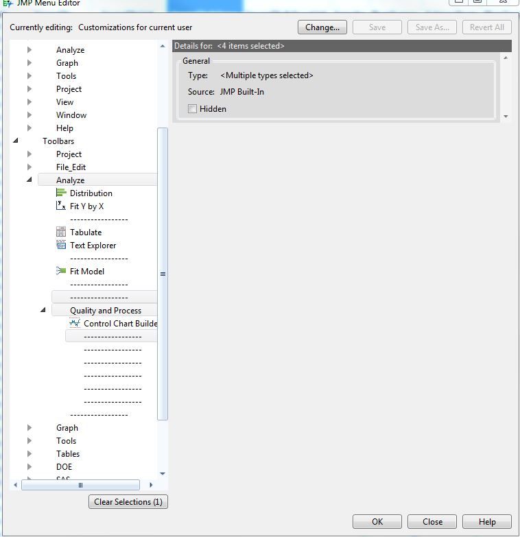

Community Member
  1. Insert before or after (Figure Step 1)
  2. Type to Insert: command
  3. Select ANALYZE: QUALITY AND PROCESS: VARIABILITY (Figure Step 2)
  4. Save
