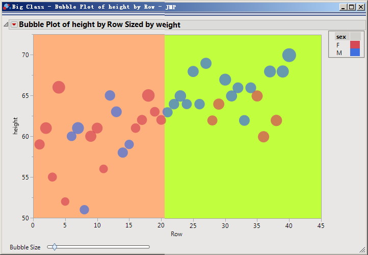

When drawing bubbles, how can I set the background color to different colors according to the number of rows?
Hello!
For example, set lines 1-20 and 21-40 to different background colors.

You could use reference lines with allow range enabled
Names Default To Here(1);
bp = dt << Bubble Plot(
	X(Transform Column("Row", Formula(Row()))),
	Y(:height),
	Sizes(:weight),
	Coloring(:sex),
	Title Position(0, 0)
wait(1);
axisbox = Report(bp)[axis box(2)];
axisbox << Add Ref Line({0, 20}, "Solid", "Red", "", 1, 0.25);
axisbox << Add Ref Line({20, 40}, "Solid", "Medium Light Blue", "", 1, 0.25);
Or then graphic scripts but I think reference lines with range are easier in this case.

Not work.
Fill Color("blue"); Rect( 1, 80 , 20 ,50,  1);,

Thank you for your help!
dt=Open("$SAMPLE_DATA/Big Class.jmp");
bp = dt <<Graph Builder(
	Size( 532, 453 ),
	Show Control Panel( 0 ),
	Variables(
		X( Transform Column( "Row", Formula( Row() ) ) ),
		Y( :height ),
		Color( :sex ),
		Size( :height )
	Elements( Points( X, Y, Legend( 17 ) ) )
axisbox = Report(bp)[axis box(1)];
