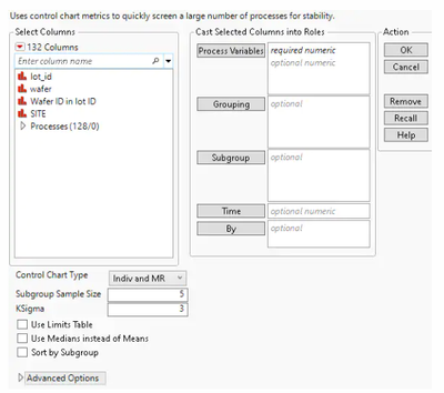

The Process Screening launch dialog gives you options to specify a Subgroup column. And also the option to specify a Subgroup Sample Size.
Take a look at the help documentation for this platform.
