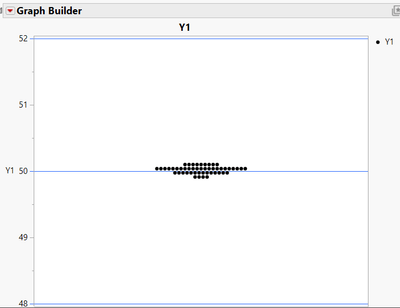

When I choose to display the limits as reference lines, two labels are automatically added to the graph, which hide the original values.How can I show the labels and values ?

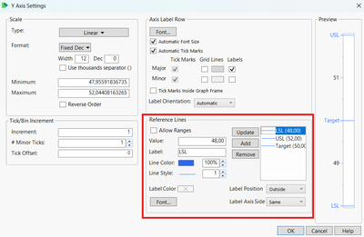

Hi @ClassSpacesOx28,
If you right-click in the axis of the graph that shows the labels and select "Axis Settings", you will have hte option to customize the reference lines :
Select the reference line you want to change, remove the label and update the settings, this will clear the label on the graph and will keep the original values instead :
Hope this answer will help you,
