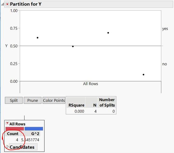

Create a simple example to see. I created a small four row data table:
The actual values don't matter for what we are doing here.
Now go to the Partition Model platform. Specify the Y column as the Y, X as the X. Ignore the Freq column for now. This is what you see once the platform launches:
Notice the count that I circled in red. Our table had four rows so count is 4.
