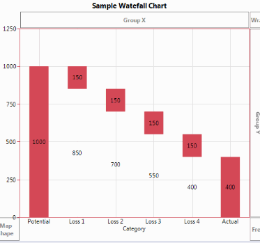

I am trying to create a waterfall chart using the Graph Builder platform.  This is what I have so far.  I now have two issues to resolve:  How to change the color or any of the bars;  I want the Potential and Actual bars to be blue, Loss bars to be red, and any credit bars to be green.  Also, I want the labels showing in the white space to not be shown.  Any help would be appreciated!  Thanks!

Have you tried using Brady's Add-in for waterfall charts?
https://community.jmp.com/docs/DOC-6235
I think at its core it's using the graph builder like you are trying to do.  Might save you some time.

Michael,  Yes, I have tried the add-in by Brady Brady. however, there appear to be some problems;  A.)  There is no hot spot to save a script, so you have to regenerate the waterfall chart(s) individually every time you update the data.  I have 21 charts I need to update at least twice per week.  B.)  You cannot copy and paste the charts to PowerPoint.  When I try, I only get the grid to paste with an error message (Graphics script reported errors in log) without the bars.
