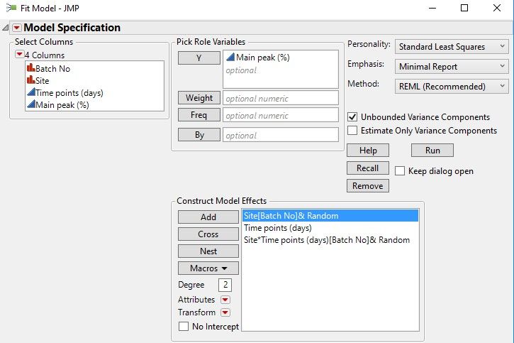

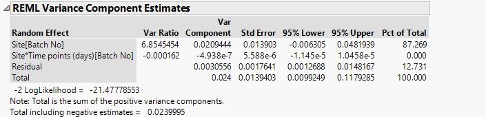

I am currently using JMP 12 for my analysis . I need technical inputs on following aspect
- I am using mixed effects model to assess whether the difference between sites is significant
- I would like to know the wald p value corresponding to Random effect Site *time [batch] to infer whether impact is significant or not
Please let me know if there is any possibility see wald p value info in version 12 . If there is no option please let me know the formula or procedure that can be used to calculate the wald p value

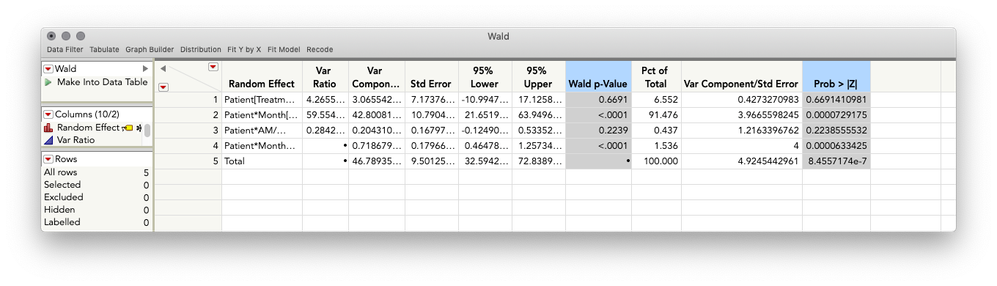

Sure thing. That p-value is calculated with Z as the reference distribution, and the Variance Components table has all the ingredients to get the test statistic. You can save the table yourself (right click > make into data table), and then make two new columns, the ratio of the variance component to the standard error, and then a second column, a lookup of that quotient in the z-distribution, with some simple arithmetic to find the proportion more extreme than that value in the reference distribution. Here's an example of that:
Names Default To Here( 1 ); dt = Open( "$SAMPLE_DATA\Cholesterol Stacked.jmp" ); platform = dt << Fit Model( Y( :Y ), Effects( :Treatment, :Month, :Name( "AM/PM" ), :Treatment * :Month, :Treatment * :Name( "AM/PM" ), :Month * :Name( "AM/PM" ), :Treatment * :Month * :Name( "AM/PM" ) ), Random Effects( :Patient[:Treatment], :Patient * :Month[:Treatment], :Patient * :Name( "AM/PM" )[:Treatment], :Patient * :Month * :Name( "AM/PM" )[:Treatment] ), NoBounds( 1 ), Personality( "Standard Least Squares" ), Method( "REML" ), Emphasis( "Minimal Report" ), Run( :Y << {Summary of Fit( 1 ), Analysis of Variance( 0 ), Parameter Estimates( 1 ), Lack of Fit( 0 ), Scaled Estimates( 0 ), Plot Actual by Predicted( 0 ), Plot Regression( 0 ), Plot Residual by Predicted( 0 ), Plot Studentized Residuals( 0 ), Plot Effect Leverage( 0 ), Plot Residual by Normal Quantiles( 0 )} ) ); Wait( 0 ); Report( platform )[Outline Box( "Response Y" )][Outline Box( "REML Variance Component Estimates" )][ Table Box( 1 )] << Make Into Data Table; Report( platform ) << Close Window; New Column( "Var Component/Std Error", Numeric, "Continuous", Format( "Best", 12 ), Formula( :Var Component / :Std Error ), Set Selected ); New Column( "Prob > |Z|", Numeric, "Continuous", Format( "Best", 12 ), Formula( (1 - Normal Distribution( :Name( "Var Component/Std Error" ) )) * 2 ), Set Selected );
This will return the following (showing JMP 14 so you can see JMP's calculation of the Wald P-value, which you can confirm is the same as the one calculated in the method I described above).

Help==>Books==>Fitting Linear Models
it states for Fitting Standard Least Square models
Wald p-Value Gives the p-value for the test that the covariance parameter is equal to zero.
This column appears only when you have selected Unbounded Variance Components in
the Fit Model launch window.

Re: Wald p value not shown in JMP version 12
inspite of selecting unbound variance component in fit model launch window

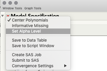

Hi @Dinesh,
P-values are not displayed for variance components in JMP 12; these p-values were added in JMP 13. I realize it's not exactly what you're looking for, but you can use the confidence intervals in much the same way as the hypothesis test at an alpha of 1-confidence level by looking to see if 0 is contained in the interval. If it is not, your p-value (for the corresponding hypothesis test) is < 1-confidence level. If you need to change this confidence level, you can do that when you launch Fit Model: click the top red triangle in the launch window > Alpha Level.

Hi @Dinesh,
