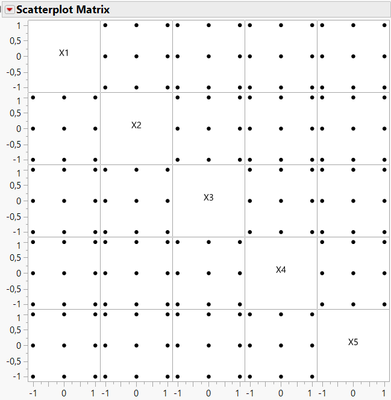

  3. Looking at a scatterplot matrix can also help see the particular structure of the DSD and absence of correlation between factors:
See more here : Introducing Definitive Screening Designs - JMP User Community
