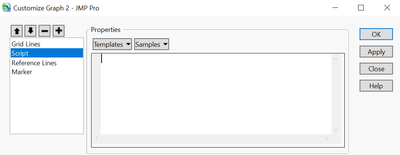

Hi, I am trying to do a vector plot in JMP but I have not been able to. The following POST had a blog on it but it looks like the blog has been archived. I am doing some data exploration and I have my dx and dy columns figured out. Is there a way to do this in graph builder? I vaguely remember that you have to updated customize graph below to make this happen (see image below)

You can open the jmp file in the post that you linked.
wow, amazingly easy:

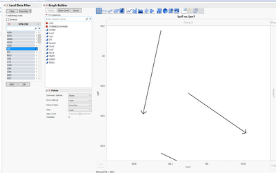

 Thanks! One thing I noticed when using 'customize...' is that when I use local data filter does remove the other vectors drawings as seen below. Is there way to only have it draw based and filter based on what is inside the local data filter
hogi
Level XIII
Re: Vector Plot in JMP
The easiest way : use a global data filter.
then you can restrict the vector plot to the non-excluded rows by:
For Each Row( If( Not( Excluded() ), Arrow( {:Lon1, :Lat1}, {:Lon2, :Lat2} ) ) );
