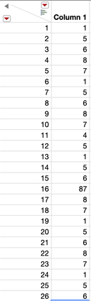

Hi,
Can somebody explain how to find the longest repeating pattern in a column?
For example, let's suppose I have the following table:
The pattern with the largest size is: "1 5 6 8 7",  and it occurs 3 times in this column. Notice that there is another pattern in the table ("1 5 6"), which occurs 5 times, but is not the largest.
I tried with Screening - Explore patterns, and although it return which values are most duplicated, I can't get the exact pattern. Or multiple patterns, with the number of occurrences.
Maybe there is some option I should enable? Or should I use some other platform? Or if somebody can help me out with a JSL script.
Thanks

Hi @ruskicar,
One possible option is to look at the platform "Explore pattern", accessible through Analyze, Screening, Explore pattern as you mention.
If you click on the red triangle next to "Column 1" in the platform window, you have the option to "Select Longest Duplicate Sequences". It will highlight in your datatable 16 rows, corresponding to 2 times the sequence "1 5 6 8 7 1 5 6", which is the longest repeating sequence you have in your dataset, not "1 5 6 8 7".

ruskicar
Level III
Re: Find the longest repeating pattern
Yes, thanks, this is what I was looking for. The example was a bit lousy I see, but the answer is correct :). Too many red triangles, so I didn't spot that option :).
