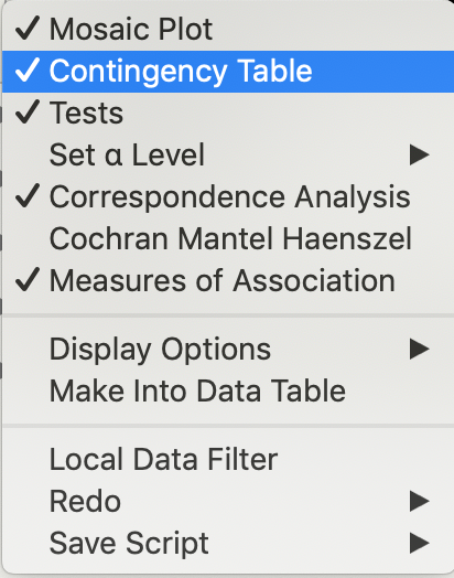

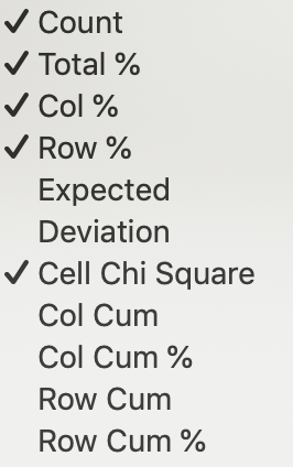

Thanks for the advice! So I was able to get contingency tables, but do not see agreement statistics. I posted a file of the two options that come up when clicking the red triangle. One is for the red triangle for contingency analysis, and one is for contigency table.
Hope i'm not being confusing! I appreciate the help i've received.

Nevermind. For some reason, when I ran it again, it worked as you said. Thanks!
