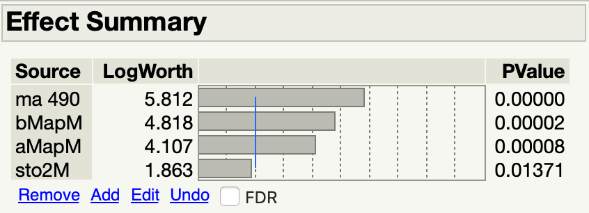

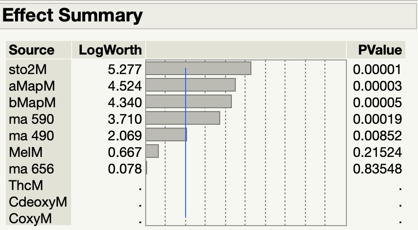

When doing the logistic regression as you mentioned, would I simply just interpret the results with P<.05 as significantly correlated? Additionally, when removing features that are insignificant, the significance increases for the others. I have attached images below showing this.

The choice for statistical significance is up to you. The criterion of P-value < 0.05 is not universally acceptable.
Yes, the statistics, including p-values of any term depend on the other terms in the model. That is why they change when you add or remove a term. That is also why we recommend removing one term at a time (e.g., the one deemed least significant) and re-evaluate the new model estimates.
I think that the sign of the parameter estimate will tell you if the variable is associated with an increase or decrease in the log odds ratio.

Sorry, here were the images.
