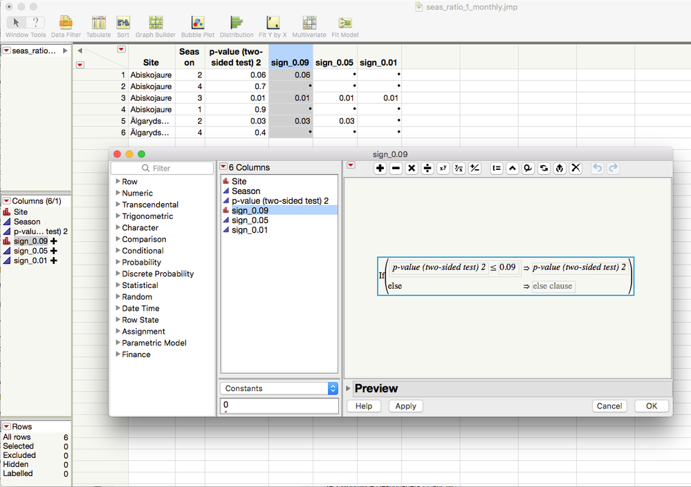

Pacco
Level III
Re: Value selection and copy into new columns
Jeff_Perkinson
Thanks for posting some more details, that helps some. Instead of trying to create the new columns and filling them with values all through JSL, I would just create three new formula based columns with the formula:
If( :Name( "p-value (two-sided test) 2" ) <= 0.09,
dt = Open( "seas_ratio_1_monthly.jmp" );
dt << New Column( "sign_0.09",
	Numeric,
	"Nominal",
	Format( "Best", 9 ),
	Formula(
dt << New Column( "sign_0.05",
	Numeric,
	"Continuous",
	Format( "Best", 12 ),
	Formula(
		If( :Name( "p-value (two-sided test) 2" ) <= 0.05,
dt << New Column( "sign_0.01",
	Numeric,
	"Continuous",
	Formula(
		If( :Name( "p-value (two-sided test) 2" ) <= 0.01,
But, I must admit that I'm still not sure what the value of the data tables with only the rows that are significant at a particlar level. How are you going to use those tables? Do they need all three significance indicator columns (i.e., sign_0,09; sign_0,05; and sign_0,01)? If not you can avoid creating those columns all together and just subset the rows that less than each level. Can you tell us more about your ultimate goal and why you want data tables like you describe? We may be able to provide even easier methods.
-Jeff

SR1 = dt << Select Where(:Name("p-value (two-sided test) 2") <= 0.09) << Get Selected Rows;  // You can edit this to conform to european convention of 0,09
dt << Clear Select;
Dummy[SR1,0] = ColVals[SR1];
dt:Name("sign_0,09") << Set Values(Dummy);
// Re-initialize dummy matrix
Dummy = J(NRows(dt),1,.);
SR2 = dt << Select Where(:Name("p-value (two-sided test) 2") <= 0.05) << Get Selected Rows;  // You can edit this to conform to european convention of 0,05
dt << Clear Select;
Dummy[SR2,0] = ColVals[SR2];
dt:Name("sign_0,05") << Set Values(Dummy);
SR3 = dt << Select Where(:Name("p-value (two-sided test) 2") <= 0.01) << Get Selected Rows;  // You can edit this to conform to european convention of 0,01
dt << Clear Select;
Dummy[SR3,0] = ColVals[SR3];
dt:Name("sign_0,01") << Set Values(Dummy);

Pacco
Level III
That looks great. I will test it as soon as possible.
If you refer to common elements within the 3 new columns then this is only the case regarding the selected values that will be added to each of the columns!
E.g. the selection of values <= 0,01 will also appear in columns with 0,05 and 0,09 and the ones <= 0,05 will appear also in 0,09.
Simplified:
