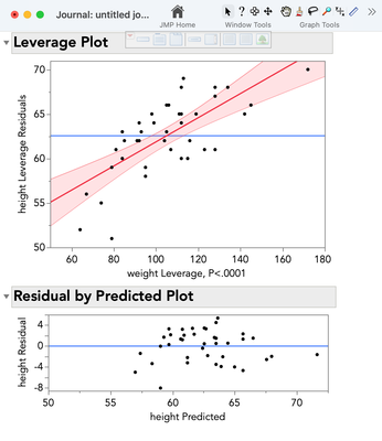

How can I generate a leverage plot in graph builder based off the leverage plot generated when running a Fit Model in JMP 16
I want to create a leverage plot in Graph Builder based on the leverage plot from a model I created using the Fit Model function and with a plot of the residuals directly beneath it. Something like this:
The top plot should be the leverage plot with the line for the alternative hypothesis and shading based on the 95% confidence interval and the bottom plot should be the residual plot.  Another post had a solution about creating a shaded confidence interval in graph builder (Link), but I don't have experience with scripting so I did know how to adapt the script they used for this purpose or how to find the formula for line for the alternative hypothesis (wasn't sure if it was just a y=x line)

Unless you're willing to learn a fair bit of JSL, this isn't going to be that easy.
The details of how to construct the leverage plots are here:
https://www.jmp.com/support/help/en/17.1/index.shtml#page/jmp/statistical-details-for-leverage-plots...
A super easy way to make this figure is to journal both the leverage plot and the residual plots from the Fit Model platfrom
File>new journal
run the analysis in fir model
turn on the select tool (type "s" on keyboard)
click on the first graph, then Ctrl+j to journal it
click on the second graph and do the same thing.
