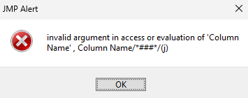

Unfortunately I tried this already and it doesn't seem to work. It still gets confused and thinks I am referring to the newly stacked table when executing the i=2 iteration. I can tell because my newly stacked table has 4 columns. The error I receive is a j indexing error that fails when j=5.

I may have confused you with making 2 changes to your code, but only talking about one.   When you made your most recent test, did you use the line
tempTable = data table("Original Data") << Stack(
If you did and then got the error you specified, I will ask you to supply a sample data table, and I will explore the issue more.

txnelson
Re: Is Creating Multiple Stacked Tables From One Original Table in a Nested For Loop Possible?
It was the Column Name() function that was messing the script up.  It points to the current active data table.  Thus, I added the setting of the Current Data Table back to the original Sample data table.
