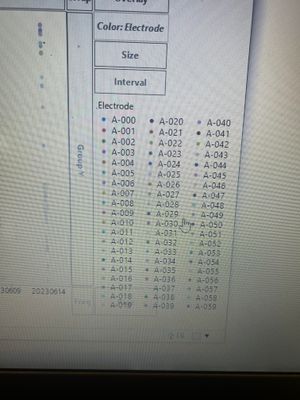

I have a variable with 128 samples, called Elect, and I am in graph builder and I drag that variable in the color box. However it only shows 60/128 of the varibales. Anyone hve any idea how to go on so all variables are seen. I basically have an X and Y variable already on and wanting to see a scatter plot of everything at once with the Elect variable added in the color section/box.

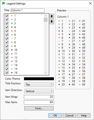

Double click on the legend and change max items

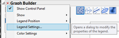

You can also get to the same menu from Graph Builder red triangle and Legend Settings

Hi thank you, I'm not seeing Max Items as an option, have any idea why that could be?
