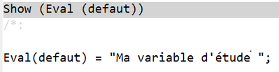

I have not added all my script, however, the defaut variable is well define:
I tried directly with the variable itself and it does not work as well.
Any other suggestion?

mmarchandTSI
Level V
Re: Error message from Elements( Points( X, Y, Legend( 2 ) ) ),
As long as "Ma variable d'étude " is the name of a column in RAW_DATA_TABLE, this should work.  I believe that's what @Thierry_S was getting at.  Double check to make sure that "Ma variable d'étude " is the name of a column in the data table.
