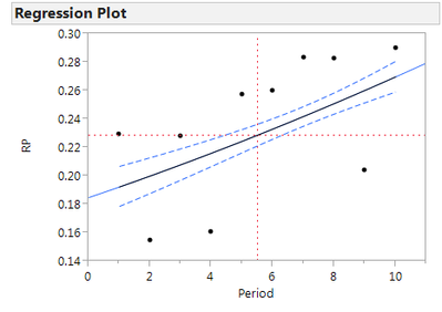

I want to do something similar but with a twist.  I'm doing a Fit Generalized Model, and I want to show confidence curves on the regression graph.  I can right click on the profiler and select Edit > Copy frame contents.  Then I right click on the regression graph and select Edit > Paste frame contents.  This is my result:
My question is: how do I do this in JSL?  This is my (feeble) attempt but it doesn't work:

Hi @pmroz ,
  I can't duplicate the error you are experiencing without using the same data table. But, your code should be working in general.
  I tested something similar out on the Titanic Passengers.jmp file. The below JSL code works and it copy/pastes the contents from the one report (profiler) to the logistic fit plot of the other report. I followed your same basic JSL and it worked.
Names Default to Here( 1 );
fm = Fit Model(
	Y( :Survived ),
	Effects( :Age ),
	Personality( "Generalized Linear Model" ),
	GLM Distribution( "Binomial" ),
	Link Function( "Logit" ),
	Overdispersion Tests and Intervals( 0 ),
	Name( "Firth Bias-Adjusted Estimates" )(0),
	Run( 1, Profiler( 1, Confidence Intervals( 1 ), Term Value( Age( 29.881, Lock( 0 ), Show( 1 ) ) ) ) )
fmrep = fm << report;
lf = Logistic( Y( :Survived ), X( :Age ) );
lfrep = lf << report;
fmrep[framebox( 2 )] << Copy Frame Contents;
lfrep[framebox( 1 )] << paste frame Contents;
  I could also get it to work on the Desirability vs Age within the GLM report window.

pmroz
Re: Using JSL to copy the frame contents of one graph to a different graph?
Hi DS,
Thanks for your response, but I changed tactics a while ago.  I do the regression analysis, save the results to a table, and use Graph Builder to display the results.  No more copy/pasting.
