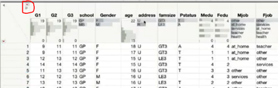

I was watching this really nice overview by Kevin Potcner, and at 5:19 he clicks a button in the very top left of the data table and says, "And a quick way to get a sense of what the data looks like in JMP is up here there's this little histogram button, and what it actually does is give me this little mini view of all the data, so I've got these histograms as you can see..."
Seems like a neat feature! But I don't see the button on my JMP. Is there a way to enable this view?
Running JMP Pro 14.3.0 on Windows 10.

That's a feature that was added in JMP 15. You'll need to upgrade to the current version, JMP 16 to get it.
