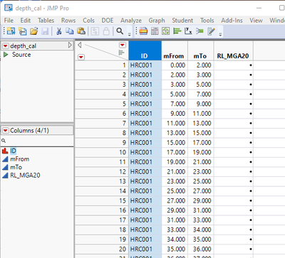

The description of the data table attached to your entry is different from what is in the attached data table.  The attached data table contains
ID
mFrom
mTo
RL_MGA20
What you describe is that your data table has
     "The columns with data will be ID, From(Depth),and RL"
I do not understand what you are asking for
Jim

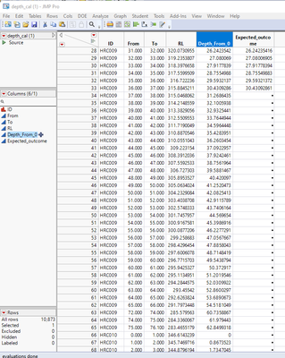

 What I am trying to achieve is to create a depth from a common plane / point which is the collar of a drill hole.
If ID=ID (from the same hole) and From = 0 then RL(value where From = 0) - RL .
I have update the file to better reflect the question, also i added a column Expected_outcome to show what i am trying to achieve.
ID is the drill hole name
From is the depth from the collar at surface
RL is the height of the point with respect to sea level.
Depth_From_0 would be the depth below the surface where From=0 and the corresponding RL

Here is the formula I used to get the below results
If( :From == 0, hold = :RL );
hold - :RL;
