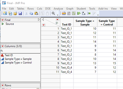

Here is a little script that converts your simple example table into the new format you want.  It uses a couple of subsets along with an Update to accomplish the task.
Names Default To Here( 1 );
dt = Current Data Table();
dt << select where( :Sample Type == "Sample" );
dtFinal = dt << subset(
	selected rows( 1 ),
	columns( {"Test ID", "Result"} ),
	Output Table( "Final" )
dtFinal:Result << set name( "Sample Type = Sample" );
dt << invert row selection;
dtTemp = dt << subset( invisible,
	selected rows( 1 ),
dtTemp:Result << set name( "Sample Type = Control" );
dtFinal <<Update(
	With( dtTemp ),
	Match Columns( :Test ID = :Test ID )
close( dtTemp, nosave );

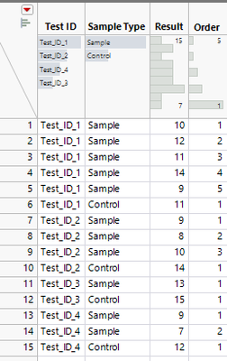

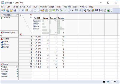

You can also try to create grouping column
Col Cumulative Sum(1, :Test ID, :Sample Type)
Use that with Split
And then select one row from control colum and fill with previous value
and cleanup (remove order column, re-order columns, rename if needed)
This works in this fairly simple case, but it is also fairly easy to loose data when using JMP's split platform so be careful with (order column tries to prevent this).
-Jarmo
	selected rows( 1 ),
	selected rows( 1 ),
dtFinal <<Update(
	With( dtTemp ),
Use that with Split
-Jarmo
