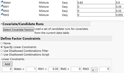

Hi @Alainmd02 ,
You need to set this up with a linear constraint to define that the ratio of RM1:RM2 >= 0.26.
I find the best way to get the equation for the constraint is to define 2 points that obey the constraint (e.g. 0.1, 0.385 and 1,3.85) and fit a line using Fit Y by X in JMP.
This gives you the equation, RM1 = 0 + 0.2597403*RM2, and you just need to rearrange into a form that fits the constraints interface.
Here is the script for the Custom Design.

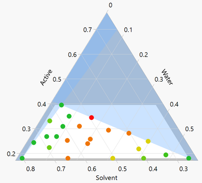

Regarding 2.: I did something like this in a project when I was working in the chemicals industry. We had the same aim, which was to understand what parts of the formulation space gave us clear, homogeneous solutions. We rated clarity on a scale of 1-5. And we also heated up the samples to 70C and rated them as they cooled to 60, 50, 40, 30 and 20. I struggled to build useful statistical models of the data. The visuals of this data were very useful though. Here is a plot of the (anonymised) data for 20C. You can clearly see the good, green regions. That was all we needed to know for our objectives.
