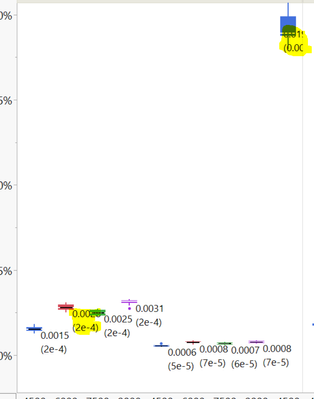

Using Graph builder I'm struggling to make graphs that list the mean and standard deviations of box plots. I discovered I could use the boxplot & Line of Fit to report the means and stardard devs next to each factor, but the reported numbers are oddly positioned. I was hoping there would be a way to simply manually move these values on the graph so that the overall graph looks better. Is there a way to do that? Also, I noticed the means are not in the same units as the Y-axis. Is there a way to change that as well?
 I've highlighted an example below:

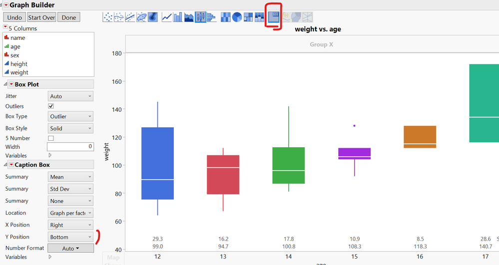

It may be different from what you want, but another approach is to use the Caption Box.
- Click the Caption Box icon.
- In the Caption Box options on the left side of the plot, select Graph per Factor from Location.
- You can change the Y-position from the option

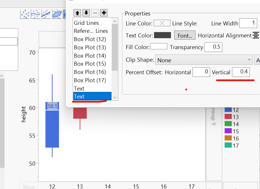

If you right click on the graph, you can select Customize to move the caption text.
