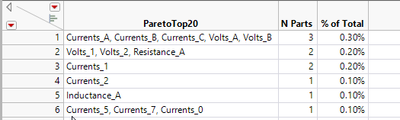

Hi,
I've a data table, looks something like this. I want to split each test and assign % values.
I am trying to create an Associative Array and allocate values to each tests but the results are incorrect. I am not sure what I missed
The final associative array should contain the following.
new_aa = [" Currents_A" => 0.003 " Currents_B" => 0.003, " Currents_C" => 0.003, "Volts_A" => 0.003, "Votls_B" => 0.003, "Volts_1" => 0.002,..................., "Currents_0" => 0.001]
Here's the jsl code. Any suggestions

txnelson
Re: Associative Array - splitting keys
Here is what I would do to get the Associative Array you are looking for
Names Default To Here( 1 );
dt = Data Table( "dt" );
// Get all columns
allOrigColumnsList = dt << get column names( string );
// Move individual elements of the column, to individual columns
dt << Text To Columns( delimiter( "," ), columns( :paretotop20 ) );
// Find all new columns
newColList = dt << get column names( string );
For( i = N Items( newColList ), i >= 1, i--,
	If( Contains( allOrigColumnsList,
		newColList[i]),
		Remove From( newColList, i, 1 )
dtStack = Data Table( "dt" ) << Stack(
	columns( eval(newColList) ),
	Source Label Column( "Label" ),
	Stacked Data Column( "Data" ),
	"Non-stacked columns"n( Keep( :"% of Total"n ) ),
	Output Table( "Untitled 60.jmp" )
dtStack << select where(:Data == "" );
dtStack << delete rows;
aa = Associative Array( Column( dtStack, 3 ) << get values, Column( dtStack, 1 ) << get values );
