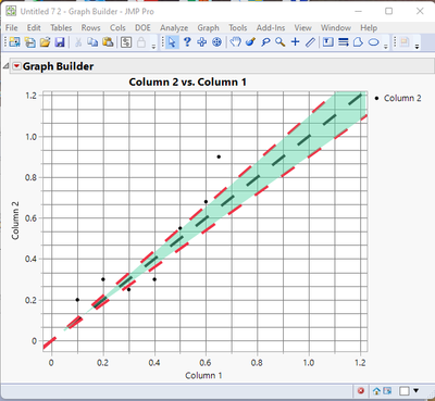

Re: Use variable in graph builder customize script window
Here is a simple example of how you can change the polygon to match the axis settings.
Names Default To Here( 1 );
dt = New Table( "Sample",
	Add Rows( 7 ),
	New Column( "Column 1",
		Numeric,
		"Continuous",
		Format( "Best", 12 ),
		Set Values( [0.1, 0.2, 0.3, 0.4, 0.5, 0.6, 0.65] )
	New Column( "Column 2",
		Numeric,
		"Continuous",
		Set Values( [0.2, 0.3, 0.25, 0.3, 0.55, 0.68, 0.9] )
gb = Graph Builder(
	Size( 528, 454 ),
	Show Control Panel( 0 ),
	Variables( X( :Column 1 ), Y( :Column 2 ) ),
	Elements( Points( X, Y, Legend( 5 ) ) ),
	SendToReport(
		Dispatch(
			"Column 1",
			ScaleBox,
			{Min( -0.0389121338912134 ), Max( 1.21814306472226 ), Inc( 0.2 ), Minor Ticks( 1 ),
			Label Row(
				{Major Grid Line Color( 1 ), Minor Grid Line Color( 1 ), Show Major Grid( 1 ),
				Show Minor Grid( 1 )}
		Dispatch(
			"Column 2",
			ScaleBox,
			{Min( -0.05302734375 ), Max( 1.20978927612305 ), Inc( 0.2 ), Minor Ticks( 2 ),
			Label Row(
Report( gb )[FrameBox( 1 )] << Add Graphics Script(
	Pen Size( 4 );
	Line Style( dashed );
	Pen Color( "black" );
	Y Function( x, x );
	Pen Size( 4 );
	Pen Color( "red" );
	Y Function( 1.1 * x, x );
	Pen Size( 4 );
	Pen Color( "red" );
	Y Function( .9 * x, x );
	Transparency( 0.5 );
	Fill Color( {0.38, 0.84, 0.67} );
	xMat = [0.05];
	yMat = [.045];
	xMax = Report( gb )[AxisBox( 2 )] << get max;
	xMat = xMat || xMax || xMax || [0.045];
	yMat = yMat || xMax * 1.1 || xMax * .9 || [0.055];
	Polygon( xMat, yMat );
Jim

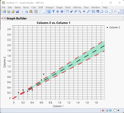

Thanks, I adapted this a bit and included Col Max (Column 2)  as the upper limit so this all goes into the smaller script environment of script builder without having to define an entire graph builder script.  Thanks for the help
Pen Size( 4 );
Y Function( x, x );
Pen Size( 4 );
Pen Color( "red" );
Pen Size( 4 );
Pen Color( "red" );
xMat = [0];
yMat = [0];
xMax = 2*Col Max (Column 1);
yMax = 2*Col Max (Column 2);
xMat = xMat || xMax || xMax || [0];
yMat = yMat || xMax * 1.1 || xMax * .9 || [0];
