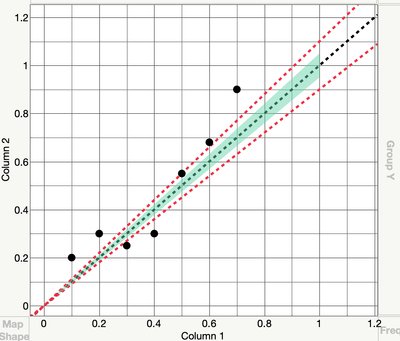

I would like to plot 3 lines and a shaded area between the outer lines using the customize script in graph builder.  The first is the line y0=x.  The second and third lines are y1= a*x and y2 = b*x.  (example a = 1.05 and b = 0.95 I want to shade between the lines y1 and y2.  I use a polygon fill to do this, but the polygon function requires fixed values and does not scale with the graph axes.  How can I make the shaded region scale with the graph as do the three lines? i.e. put a variable in the polygon function
Pen Size( 4 );
Line Style( dashed );
Pen Color( "black" );
Y Function( x, x );
Pen Size( 4 );
Pen Color( "red" );
Y Function( 1.1 * x, x );
Pen Size( 4 );
Pen Color( "red" );
Y Function( .9 * x, x );
Transparency( 0.5 );
Fill Color( {0.38, 0.84, 0.67} );
Polygon( [0.05, 1, 1, .05], [.045, .95, 1.05, .055] );

txnelson
Re: Use variable in graph builder customize script window
Here is a simple example of how you can change the polygon to match the axis settings.

Report( gb )[FrameBox( 1 )] << Add Graphics Script(
	Pen Size( 4 );
	Y Function( x, x );
	Pen Size( 4 );
	Pen Color( "red" );
	Pen Size( 4 );
	Pen Color( "red" );
	xMat = [0.05];
	yMat = [.045];
	xMax = Report( gb )[AxisBox( 2 )] << get max;
	xMat = xMat || xMax || xMax || [0.045];
	yMat = yMat || xMax * 1.1 || xMax * .9 || [0.055];
	Polygon( xMat, yMat );
Jim

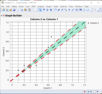

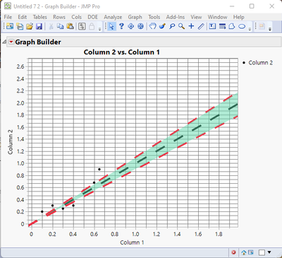

jeffsecor
Level I
Thanks, I adapted this a bit and included Col Max (Column 2)  as the upper limit so this all goes into the smaller script environment of script builder without having to define an entire graph builder script.  Thanks for the help
Pen Size( 4 );
Y Function( x, x );
Pen Size( 4 );
Pen Color( "red" );
Pen Size( 4 );
Pen Color( "red" );
xMat = [0];
yMat = [0];
xMax = 2*Col Max (Column 1);
yMax = 2*Col Max (Column 2);
xMat = xMat || xMax || xMax || [0];
yMat = yMat || xMax * 1.1 || xMax * .9 || [0];
