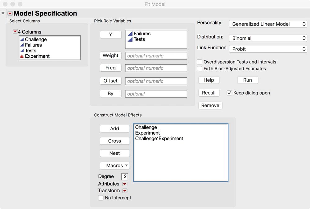

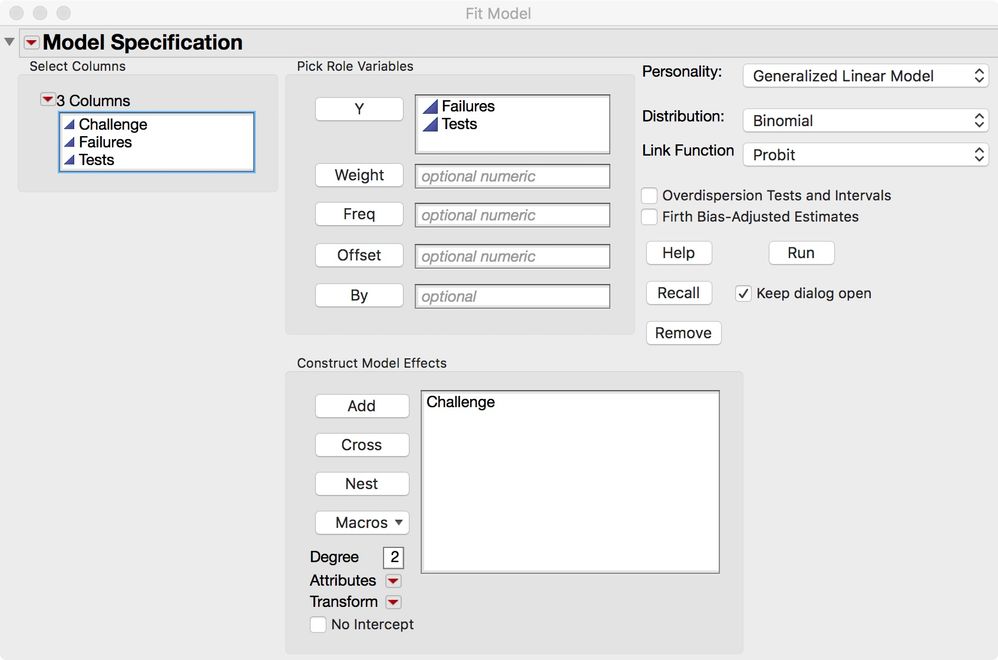

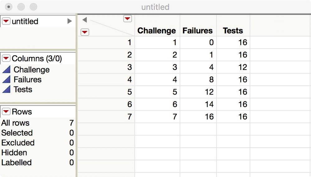

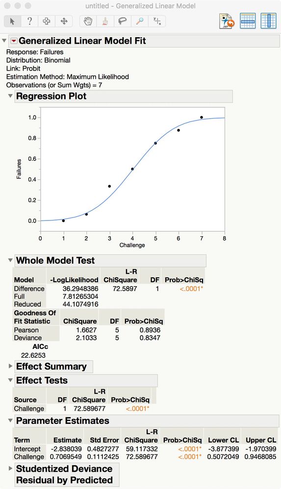

You could analyze such a table (challenge, number of failures, total number of tests - 16) using a probit model.
Select Analyze > Fit Model. Select both the Failures and Tests data columns and click Y. (Be sure to enter them in that order.) Select the Challenge data column and click Add. Click Standard Least Squares and select Generalized Linear Model. Select the Binomial distribution and the Probit link function.
Click Run.

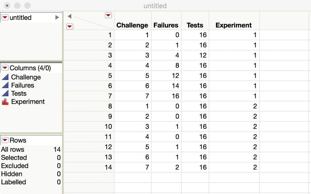

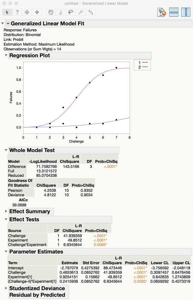

You can extend this analysis to include the experiment.
Add Experiment as two effects: the main effect and crossed with Challenge.
The estimates can be used to test the significance of the effects and the model can be used to predict.
The Experiment example here could be another categorical or continuous factor. There could be multiple factors in the probit model.
Click Run.
