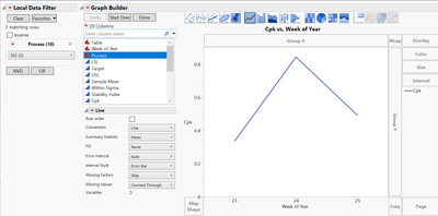

Below is the report that I want to generate. I would like to see individual reports for SI1 to SI10 (values in "Process" column) by changing the filter inside Local Data Filter. Since I would like this process to be automated in the future, I exported the script of it. But when I ran the script again, error occurred. Can anyone help to identify the error in the script? I suspect it was because the column switcher listed SI1 to SI10, which are not really columns but values in column "Process", but I'm not sure if this is the problem and don't know how to solve it. Woudl really appreciate any thought on that. Thank you!

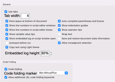

1. go to preferences > Script Editor, and make your settings look like this:
Along with a couple of other things, you'll see a log window at the bottom of your script, and line numbers.
2. Right click in your script and choose the option: Reformat Script.
This option makes the script easier to read, and also checks to see if its executable, and will likely tell you the line number where the issue is.
3. After you do this. Try running the script, it error message is unintelligible, then come back here are reply. Also send a little data that the script is supposed to work on.  That way someone who tries to help you might be able to replicate your problem without having to first try to re-invent your data.  (sometimes the data structure is the issue, not the script).
