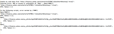

@msharp:
         I seem to get the same error as I did when I tried to use the Open command earlier. Does this have anything to do with the settings ?

Re: Use JSL to get data from the web
I can't say what your problem is, but all those commands worked for me.  I would start with basic troubleshooting steps.  Are you connected to internet? Try copying and pasting the website into the browser, does it bring up a page? (note: I would try the second page, I had to escape quotation marks in the first web address.)
What version of JMP are you running? If it's an older version, does it not support the functionality?  Are you on a mac or windows?
