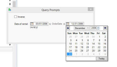

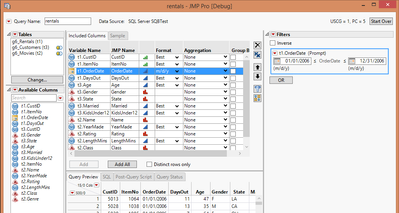

If you are on JMP 12, consider using Query Builder for these sorts of things (and if you're not at JMP 12 yet, try to get there ;-).  Query Builder lets you interactively create filtered SQL queries, and you can turn those filters into prompts.  A primary reason Query Builder was created was for situations just like yours.  Here is what the query looks like while being built:
If you look closely you can see (Prompt)​ next to the filter.  Then, when the query is run, you get a prompt that will automatically present a date picker or date-time picker, depending on the format of the variable:
Something to think about, for the future if not right away.

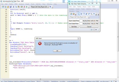

In your response, do you mean I cannot use the Number Edit Box() script function that you used to wrote for date box()?
Is this the issue that I am receiving the following warning message (Please see the image below) when I clicked on the "Get Data" button?
However how come if I directly run the script below, jmp is able to pull the request data table from sql server?

TWo things
  1. sql_statement=evalinsert("SELECT * FROM dbo.TESTCOMPLETE WHERE dCreated >= '^start_time^' AND dCreated <= '^end_time^' ORDER BY dCreated");
    1. These are not the same variables as startDT and EndDT
  2. sql_statement should be inside of RunScript
if I make the last couple lines look like this it prints fine
nw =
New Window( "SQL Data Table Extraction",
LineUpBox(NCol(2),
TextBox("Start DateTime"), start = dateBox(Today() - InDays(12)),
TextBox("End DateTime"), end = dateBox(),
ButtonBox("Cancel", nw << close Window), ButtonBox("Get Data", RunScript)
RunScript= Expr(nw<<Close Window;
  startDT=MDYHMS(start << get);
  endDT=MDYHMS(end<<get);
  sql_statement="SELECT * FROM dbo.TESTCOMPLETE WHERE dCreated >= '"||startDT||"' AND dCreated <= '"||endDT||"' ORDER BY dCreated";
  print(sql_statement);
Vince Faller - Predictum
