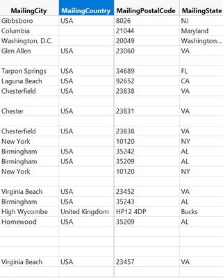

Hi,
I have two columns named 'Mailing country' and 'Mailing state'. Some of the rows under Mailing country particularly for USA does not contain any value.  I would like to update Mailing country column with value 'USA' when Mailing state contains values corresponding to various state code in the US. I have close to 250,000 rows, so manually update is not possible. I am new to JMP and scripting and I cannot figure out a way to solve this issue.
I have attached a screenshot of my sample data. Any help would be appreciated. Thanks in advance.

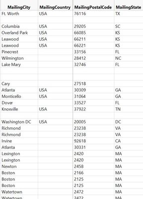

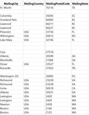

However, I notice that when I run your script, the rows without the value gets updated with "USA" whereas the rows with value present before, disappears after running the script.
I have attached a screenshot of both before and after running the script. Thanks.

Here is one solution taking a little liberty with Mark's script
For Each Row(
     temp=:Mailing Country;
	:Mailing Country = If( Is Missing( :Mailing Country ) & Contains( {"AL","AZ"}, :Mailing State ), "USA" ,temp);
